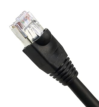

trinitypc Posted May 24, 2017 Share Posted May 24, 2017 Nice price on the connectors! Are you using ruggedized cables or standard fare? I'd love to go down the same road, but I'd prefer to stick with the added flexibility and durability of ethercon cables offered by L6/Bose/etc... For the most part, standard fare. They do have a boot/strain relief molded to the connectors, similar to the picture below (I cut off that little rubber bump so it would fit in the NE8MC-B ethercon housing). Besides two of the Line6 branded cables, I also own a 3 meter custom VDI cable that I purchased via eBay from a seller in the UK that uses Van Damme Tourcat Cat5 cable, at a cost of about $30 shipped to the USA. It's a good solid cable, but I like being able to keep a few of my "cheap" cables in my gigbag as backups. For my purposes a 25ft cable is just way too long and unwieldy, considering I'm connected to a floor Helix that I wouldn't normally be more than 10 feet away from it while on stage. Quote Link to comment Share on other sites More sharing options...
