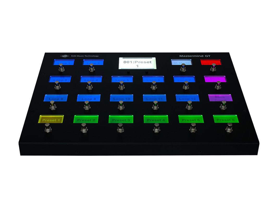

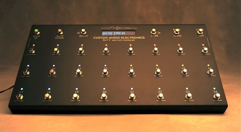

On 11/26/2022 at 5:49 PM, SaschaFranck said:
I think you can even stack the RJMs and have them communicate. €2,455 per unit isn't exactly what I'd call a no-brainer, though.
Yep.
Price is totally nonsense.
I'm in contact with a guy that does great controllers for the right money. Probably gonna grab one of these to swap my FCB1010 which has a ridicolous footprint. (these also accept "polyphonic" FS pressing)

This is not the end of the world, I will figure something out :) I have my eyes on a Custom Audio Electronics midi controller but maybe the presets/snapshots will work out in the end. Thanks guys for your replies!
