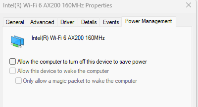

jpdennis Posted November 28, 2025 Share Posted November 28, 2025 I didn't think to ask ... Mac users will have to chime in for that OS, however, I know that Windoze (not a misspelling this time) likes to "control" power settings for many devices, USB, network etc. For my wired and wireless device properties I always make sure I DO NOT allow the computer to turn off the device to save power. Here is an example for my wi-fi device but the same is true for the wired network device. Just in case this helps for those not aware of this setting. For those aware of this setting please forgive me. jpd 1 1 Quote Link to comment Share on other sites More sharing options...

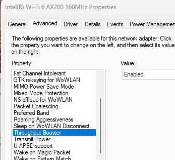

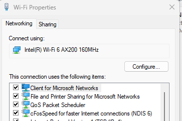

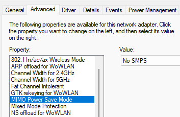

jpdennis Posted December 12, 2025 Share Posted December 12, 2025 One last thing which I forgot I do (I am that old). And there are those in the forum who may already know this that I am sharing to do and that I am old ;-). In addition to other settings I disable on my wireless systems (which I shared earlier in this thread), here are some screen shots for my PCs using the older "control panel -> network and sharing center -> change adapter settings -> right click on wi-fi adapter -> left click on properties" path. (I go the long way on most things) I then click on the configure button once the properties page comes up I choose the Advance tab then highlight "MIMO Power Saving Mode" and set the value at "No SMPS" after that i change the "Throughput Booster" to "Enabled" At this point I have never had an issue with my laptop or wi-fi adapters in towers I do not know the equivalent for the Mac users so I am relying on the knowledgeable mac users in this forum to help the Mac users. I hope this helps someone, jpd Quote Link to comment Share on other sites More sharing options...
