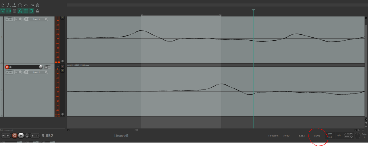

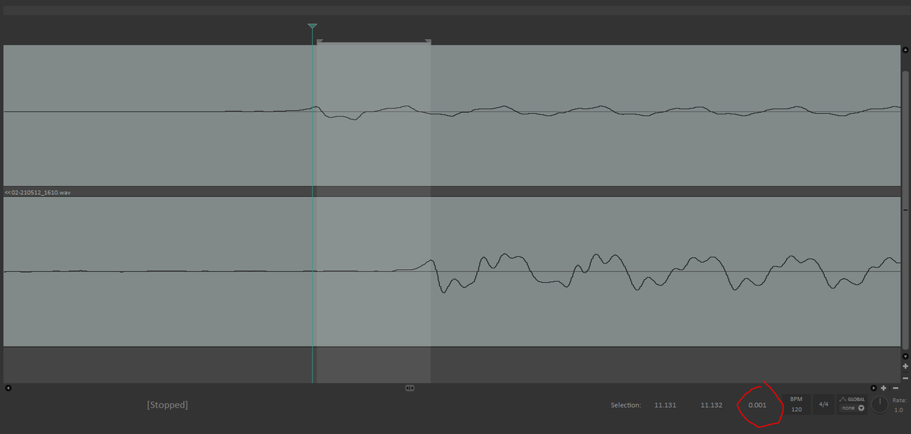

PierM Posted May 12, 2021 Share Posted May 12, 2021 Dunno, but I did the same test with my HXStomp and I get 0.001 (1ms). I assume it's gonna be the same with the Rack. Going with samples to improve measurability, at 48Khz sample rate, test gives me ~70 samples, which is around 1.4ms (70/48000=0.0014583333333333 Sec) Difference with my test is; I didn't put any block in the path, just IN to OUT. Signal at the audio interface (Focusrite Scarlett 6i6) is exactly the same. Same signal, same phase. No arbitrary reference waveform, since the waveforms are the same, just in a offset (due the latency) Reference signal goes into a Y splitter, signal A goes into HX Stomp L Input. HX Stomp L Output goes into Scarlett. Signal B goes straight into Scarlett. Adding a AMP/CAB does still give me around 1ms 1 1 Quote Link to comment Share on other sites More sharing options...
kringle Posted May 12, 2021 Share Posted May 12, 2021 PierM - that is more in line with what I'd expected. it's practically immeasurable in raw pass-through and your signals are the same. Quote Link to comment Share on other sites More sharing options...
